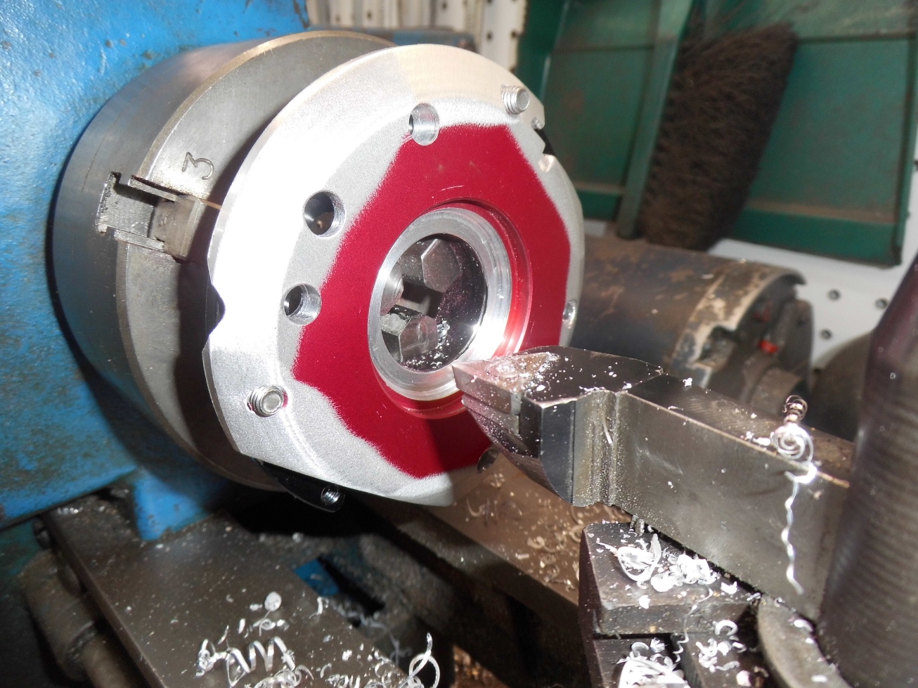

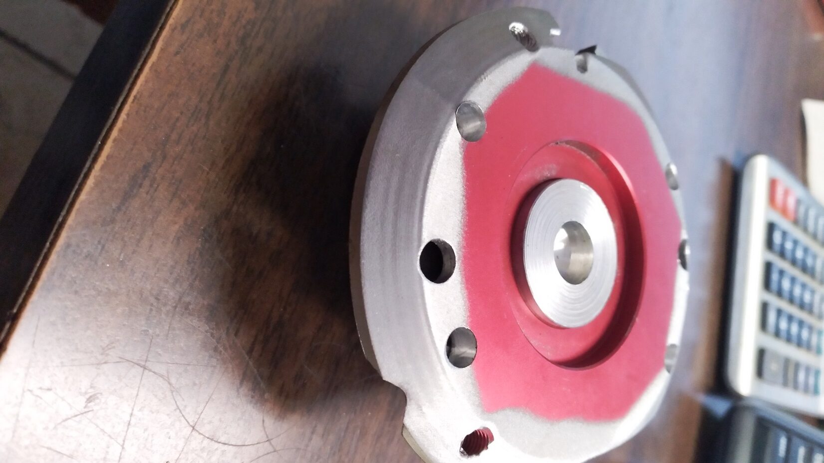

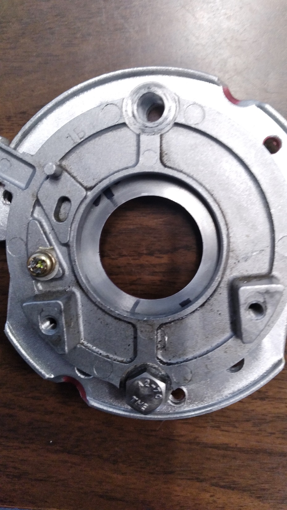

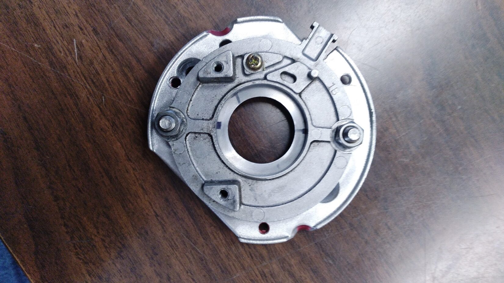

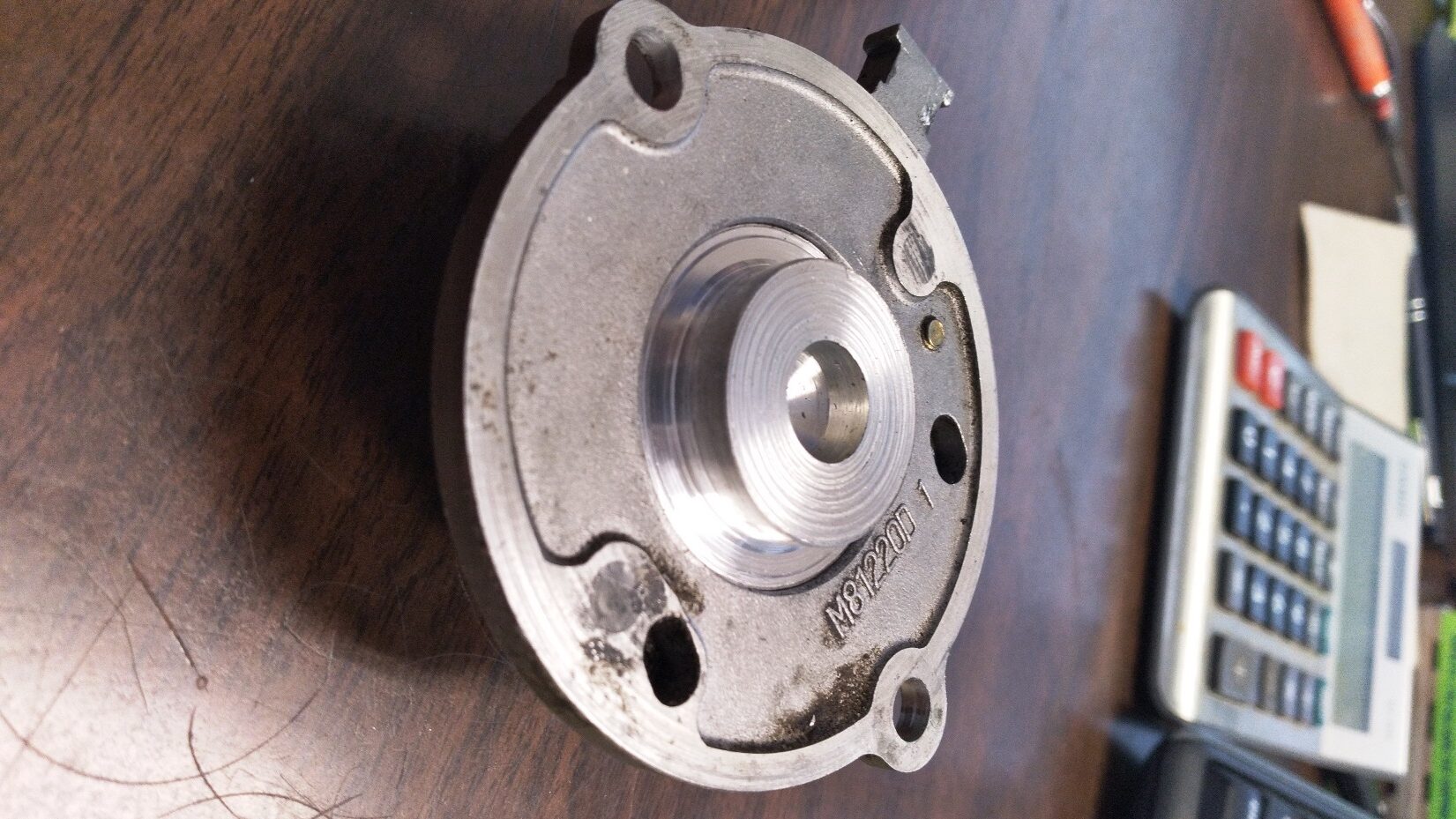

So, the hpi finally showed up. Now, 1st off it was really cheap overall, and as far as i know, the only one they have done with alighting coil for this bike. so, they modified a regular 210 unit back plate... and -almost- got it.  :dawg: luckily i have a lathe so all good there. also, the 2 mounting bolt holes are NOT (stock) same distance, and when they did the hpi plate, they missed one by about 3mm. somebody forgot to offset a caliper for radius.
so, i made an alignment plug and used the stock cdi backing plate as a drill guide. did 2 sets of holes incase i wanted to change clocking.
also, the thru hole was too small to go down over the flange @ the crank, so bored out to 38mm to center on the case.
drilled.
used winding mount as an ID grip and then bored open the hole on the plate:

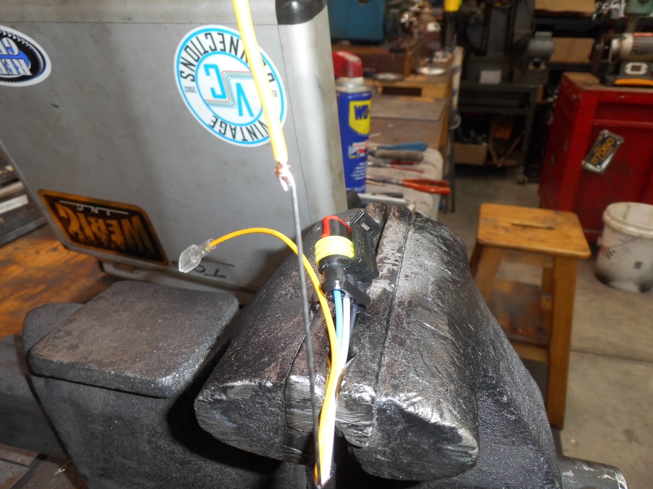

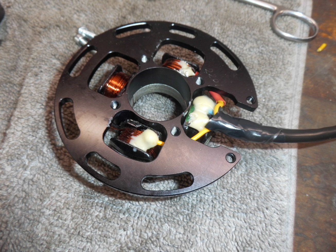

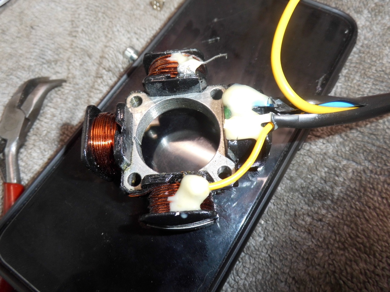

then, onto the stator. floated the ground. what you do is remove the grounded end of stator winding from ground, take off the eyelet, and tie it to a second output wire.  fishing the wire through the HPI wrap was not too bad using a section of stainless tig wire. (do this 1st)
mount back on plate and done.

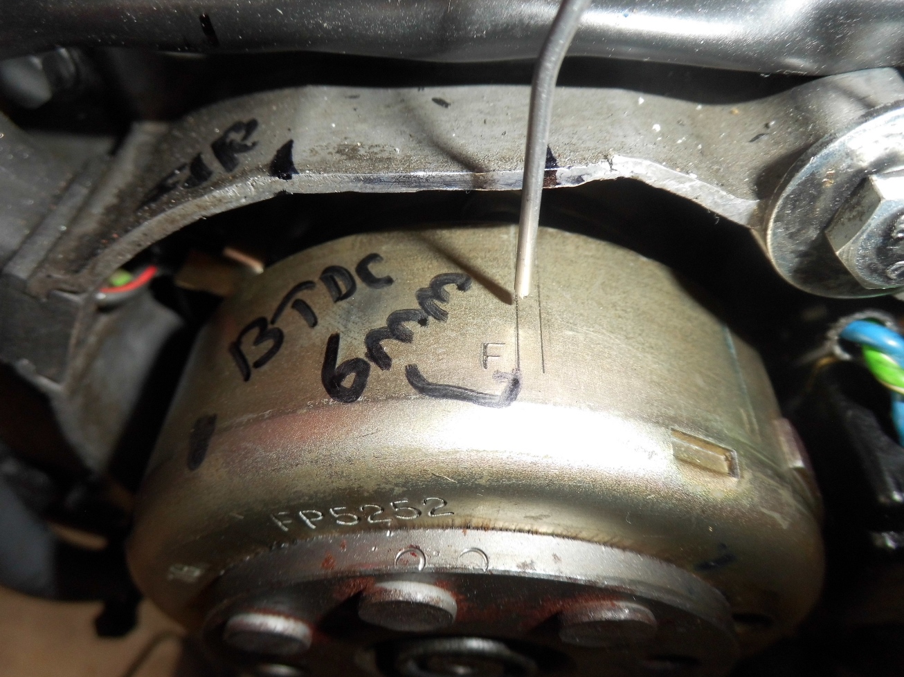

make sure you know what the stock max timing is.... because its usually NOT published on cdi bikes.
set crank to that position, then set cdi rotor to line up with mark on plate at max adv and zip down.

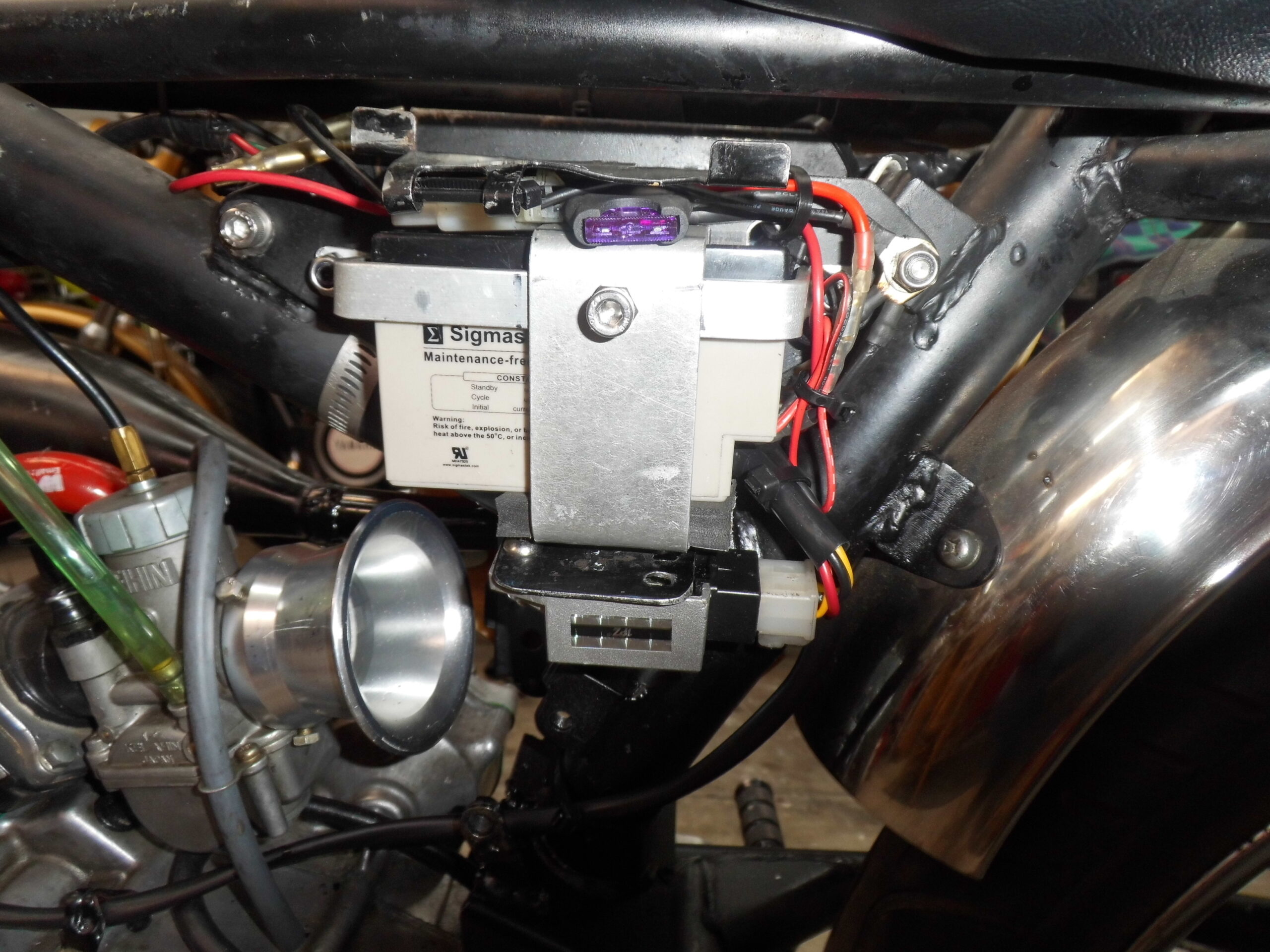

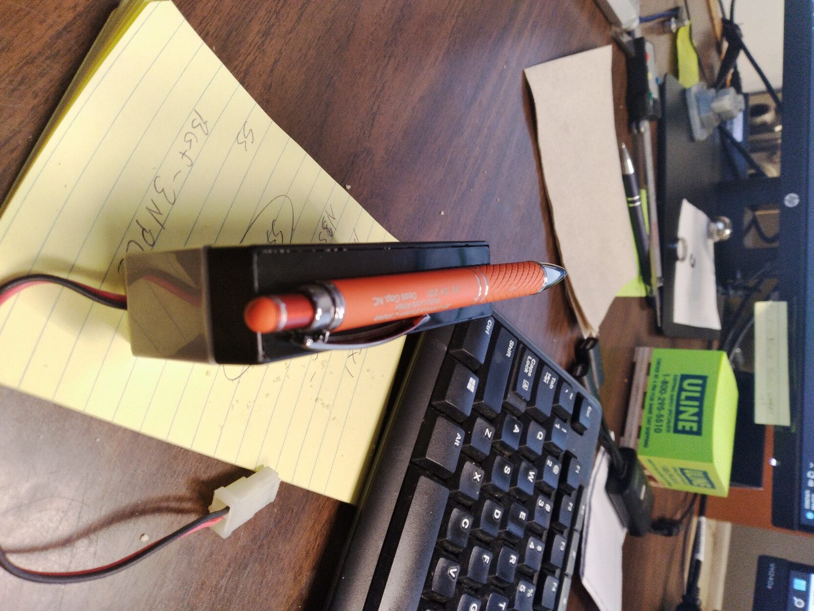

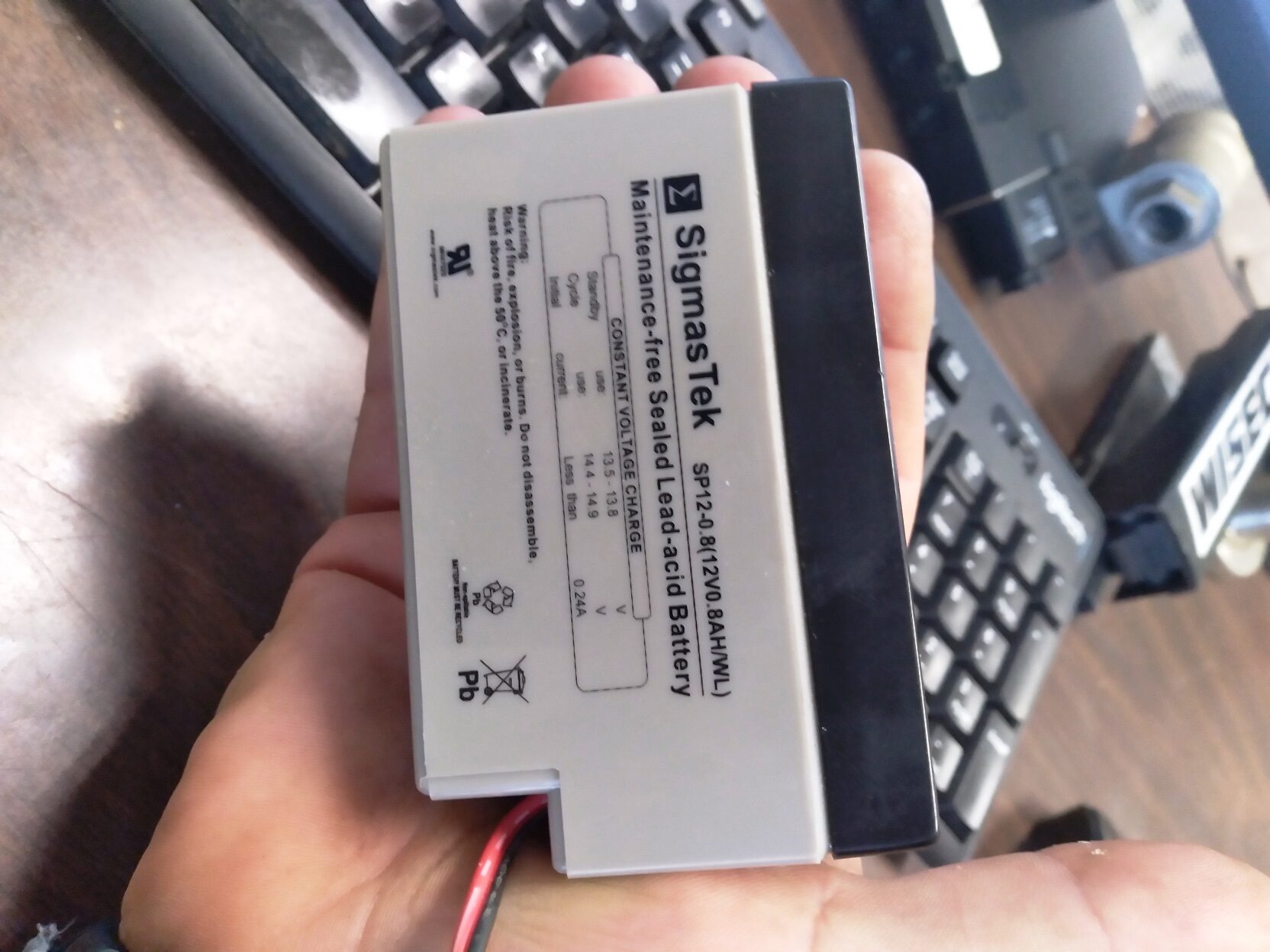

now i nee dto add the rest of the elctrical, which includes a tiny lead acid battery, 0.8 ah, 12v. also a gps sdpeedometer and regulator rectifier. thats next.
tiny battery:
yes, thats a pen on the top for size reference.
hopefully i can get it fired up tonight or tomorrow, see if the timings close.

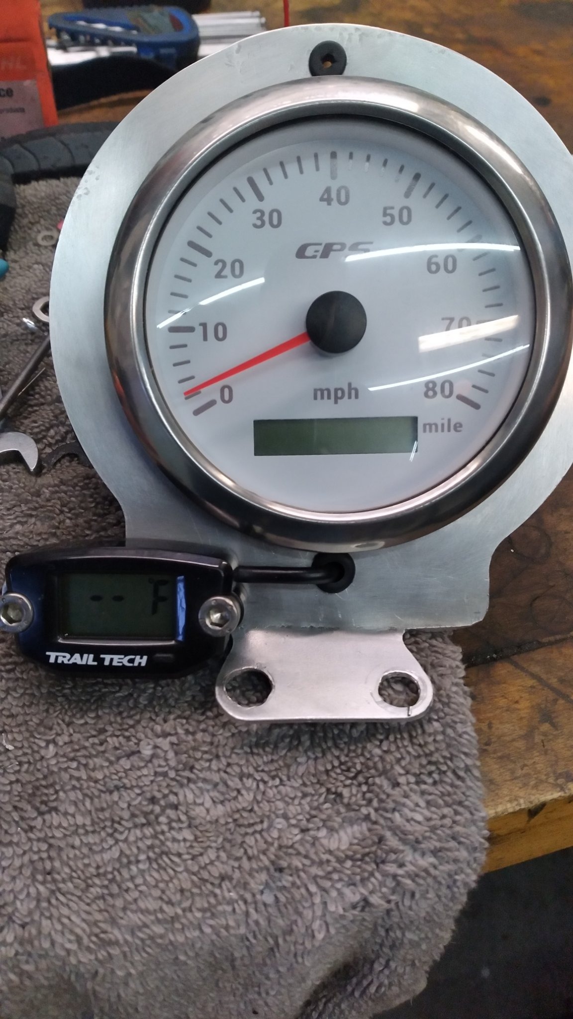

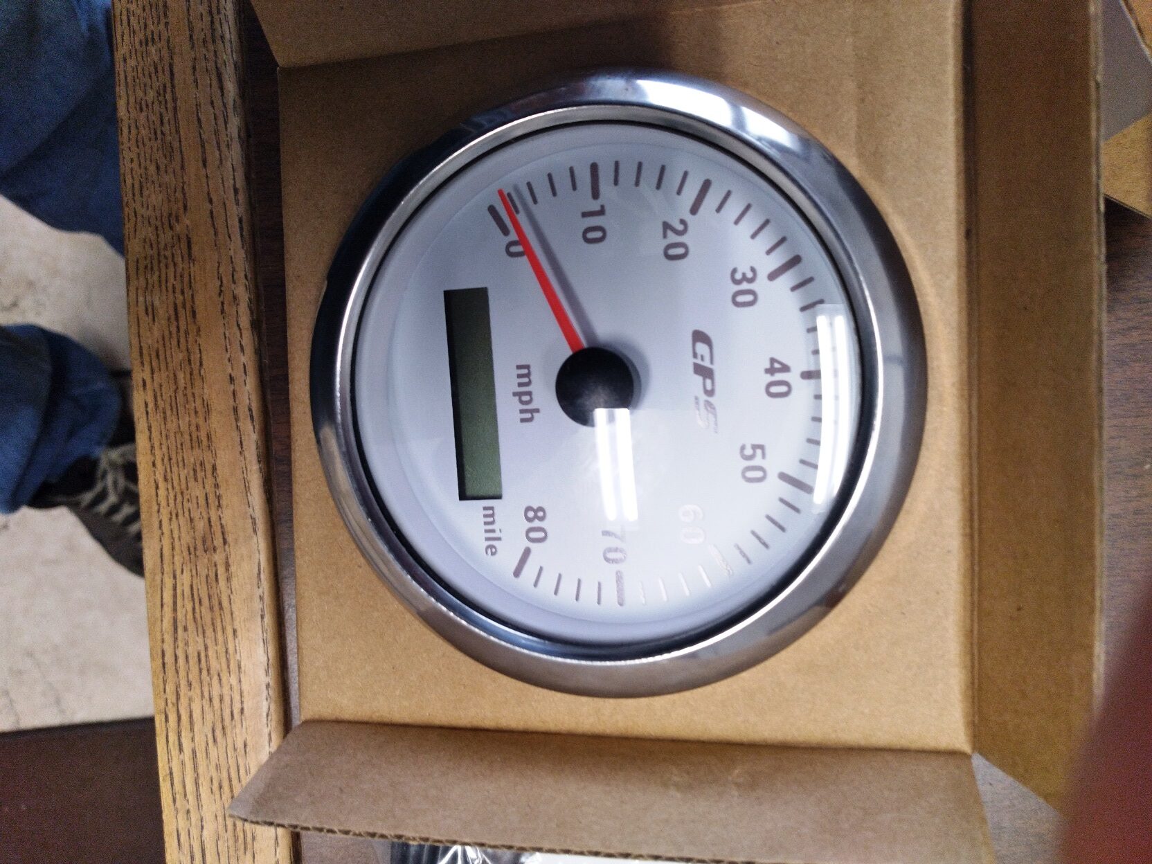

ebay gps speedometer. this thing will just do 80 mph so should be good.

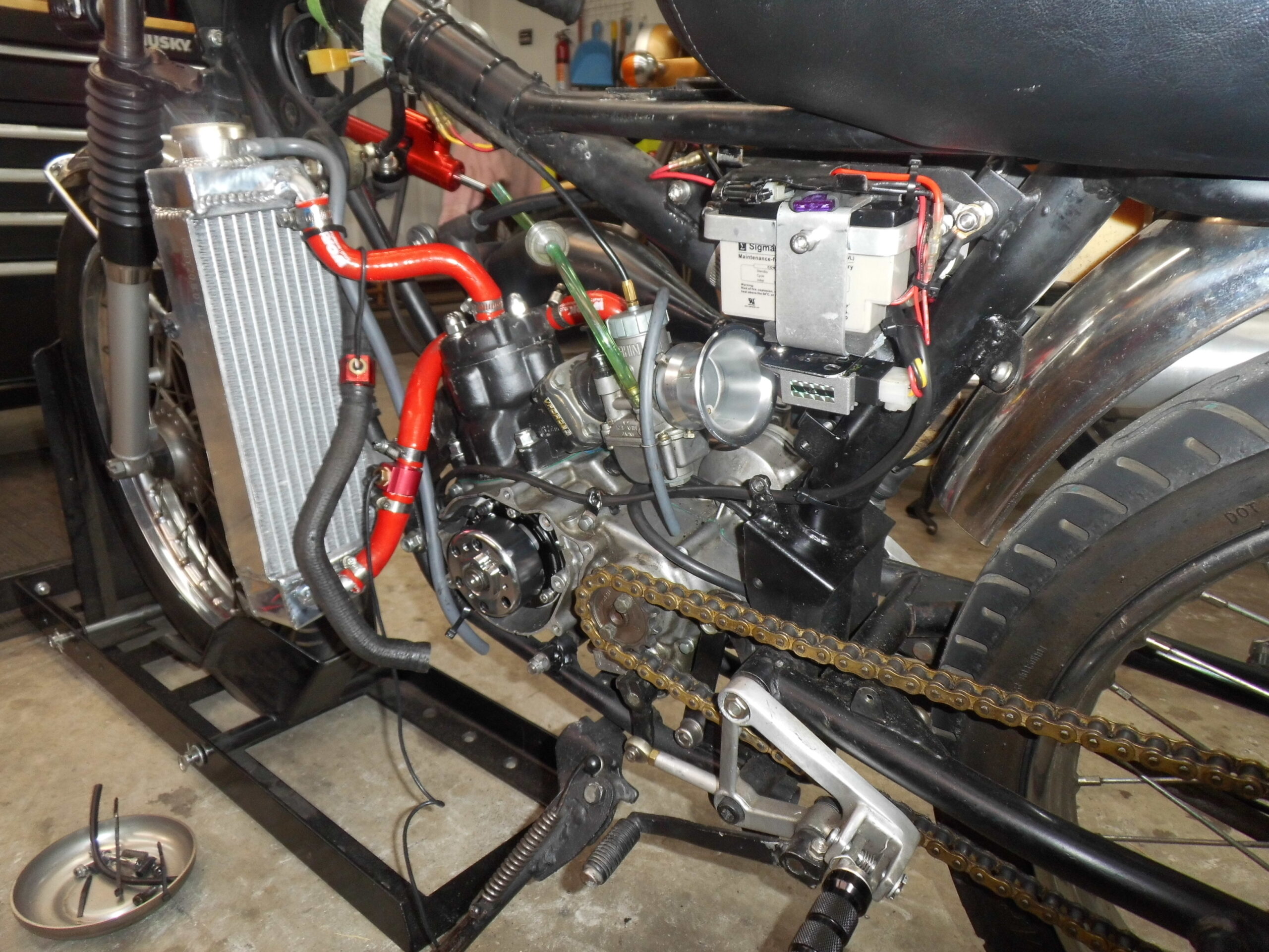

its an interesting setup for sure. got it running and charging last night. TBH its better all AC lighting if you can, but i converted to DC and its hitting 14v at a relatively high rpm, but this thing is always revving so its ok. everything is led and the only other load will be a gps speedometer, which hopefully i can install tonight. they also sell a half wave rectifier so headlight can be ac, and also charge battery.   I mean.,for the money, its hard to beat. motor def sounds crisper with it.

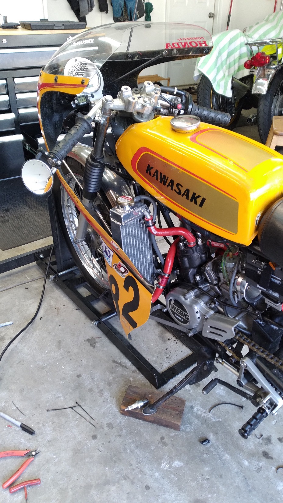

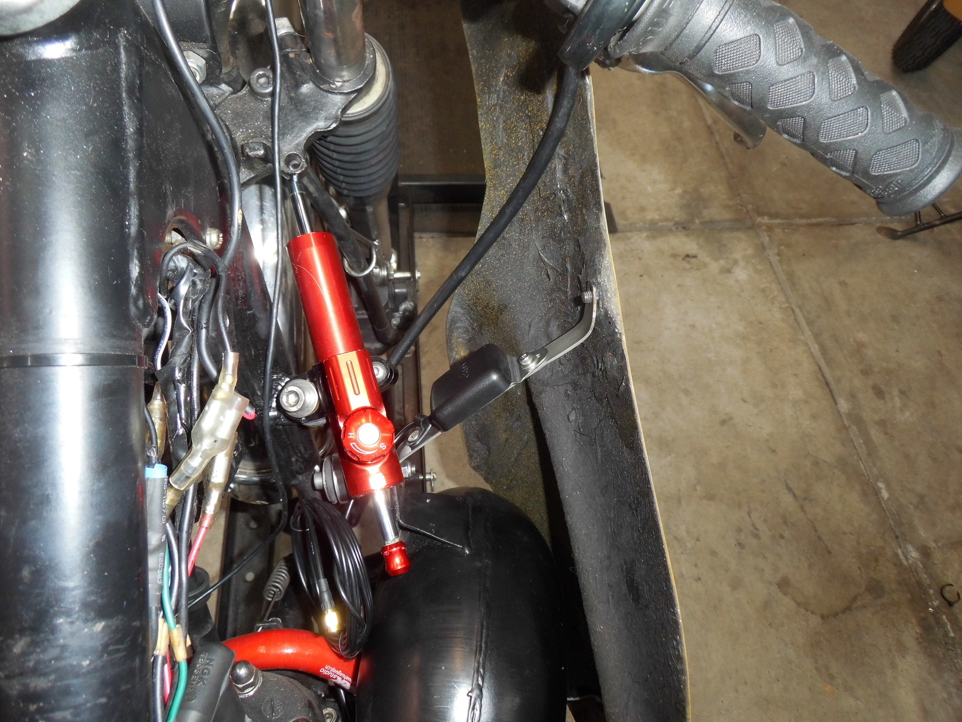

a few more shots, and speedo installed. got the battery mounted on the side under the LH cover, under it is the voltage regulator. on the other side of the bike (rh side cover) is the cdi unit and the coil. the HPI seems to charge the battery ok, goes over 13v when revving, and the lights are bright.

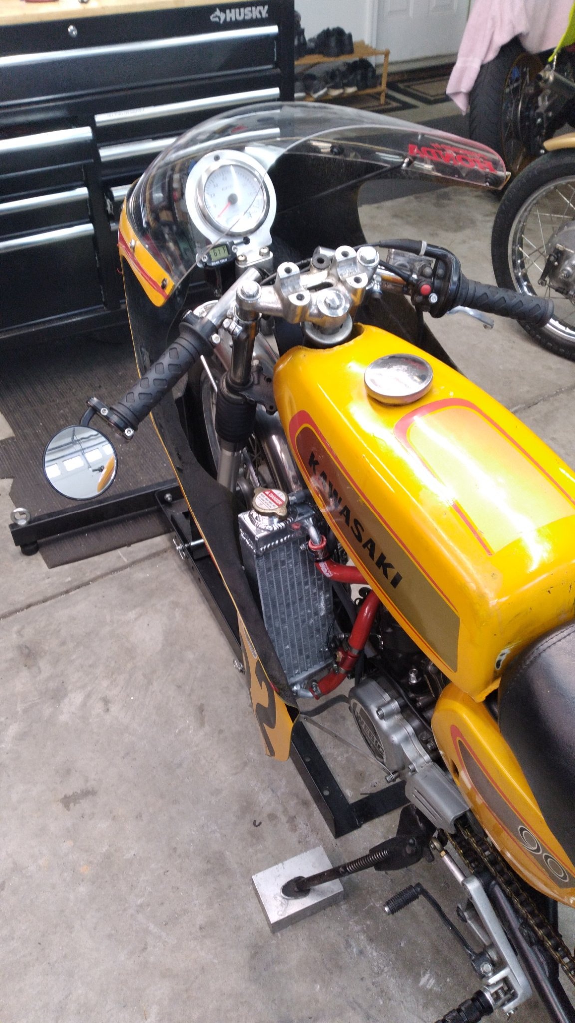

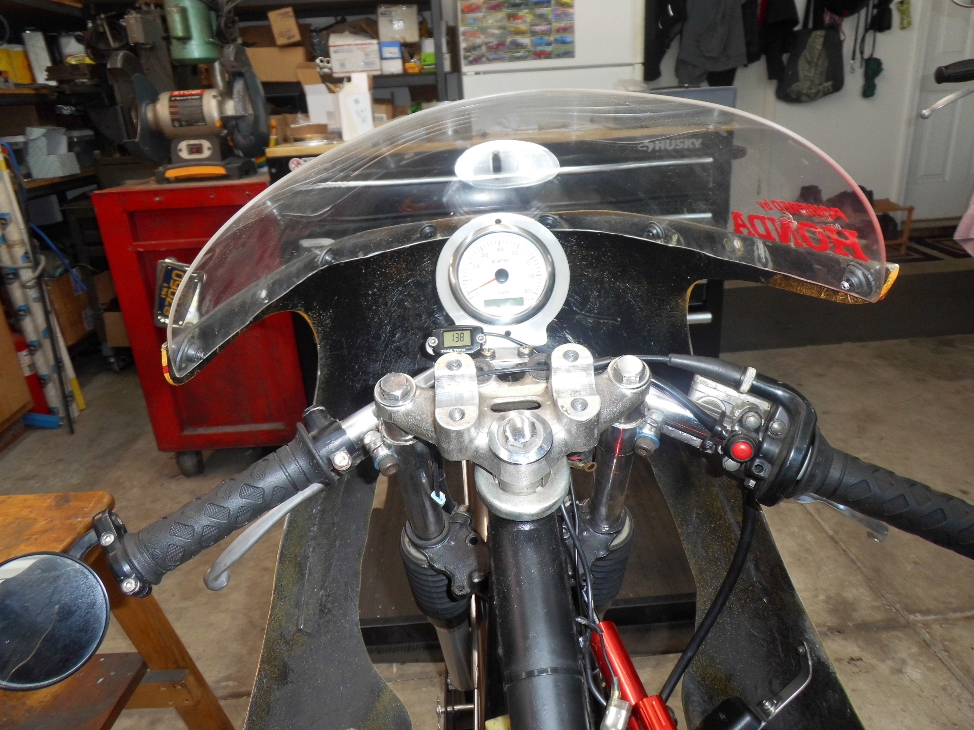

gps speedometer also installed, easier to read out front considering how small the bike is. the antenna is on the RH side on a fender stay under the steering damper.
took it back out Saturday after i got all this tied back up and wiring secured, seems to run crisper w the hpi and start easier.
needless to say, most of these pics were all taken w the bodywork off, its all sorted now and wires tied up and secured.
dare i say im 'done' for now.  :vroom:

so this thing was giving me fucking fits getting it dialed in. The HPI is doing its jop for sure, but i had an intermittent issue w the charging coil where i floated the ground, so had to resolder that end secure it differently. Then tuning was off a bit as well i guess, not related but still. Finally got the tune where it needs to be, which took a good chunk of Saturday and lots of annoyed neighbors. well, sort of.
I also had to use a slightly larger battery as the tiny one was discharging a bit much at idle, so went to a TTR50 unit, which -just- fit in the sidecover and seems to have cured it.

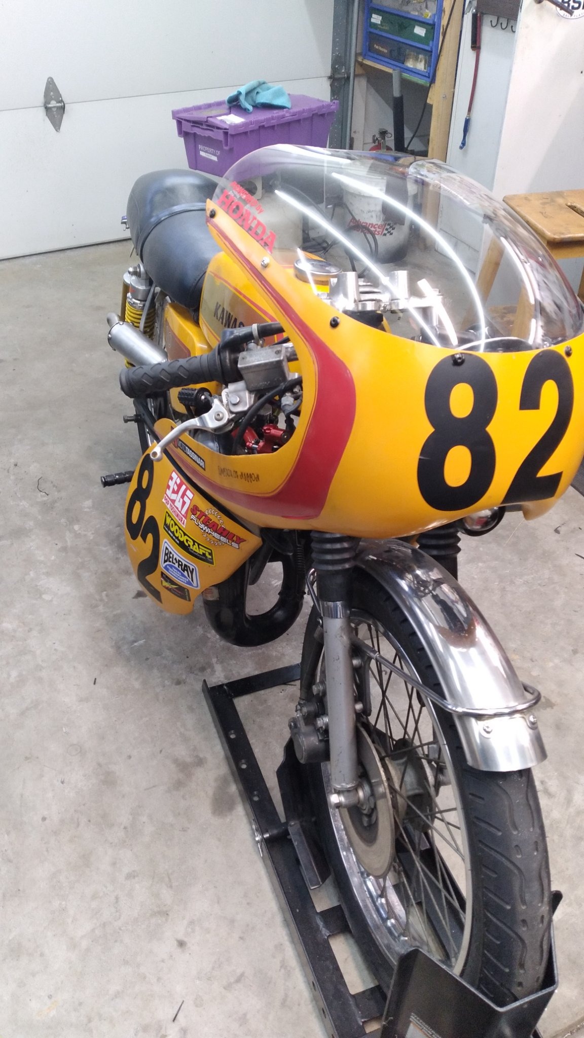

got it up to 75 mph on a short test run Saturday but too much traffic to really rail on it. But, its 95-98% id say.  :cheerleader:
Bad Ass little screamer!  :thumbs: Love the 71 paint scheme and graphics for Kawasaki including this model. I'll bet cops do a double take when you take it out on the streets!  :eek: :olaf:
