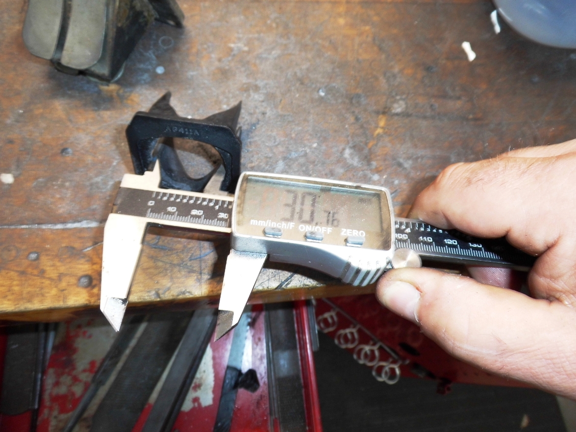

reed petal width:
depth:
v force:
v force reed width:

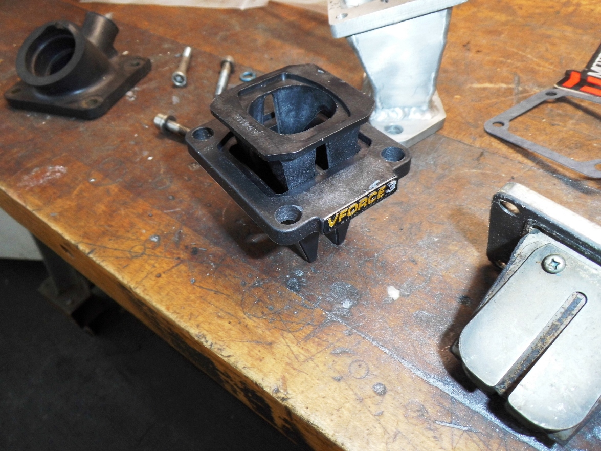

bolt pattern not fitting:
drill holes , step the drilling . start with 7mm, then open up to 8.5mm Minimally, up to 9mm.
slow drill, go easy.
all drilled out:
open up the left and right ID of the reed stuffer on the v force with a round file. they are a bit small on the sides, you need to remove about 1/2-1mm per side.
install like stock unit, but use gasket between reed and intake as well. will need ot trim ears off  astock intake if you have one.
done. 4 petal c/f reeds.
