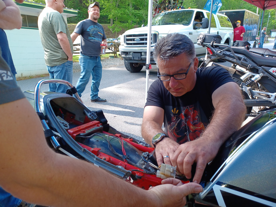

On the 2nd Dragon Run the Gray Ghost experienced intermittent ignition failure about 2 miles in. Frank B and I managed to jiggle some wires around and made it back to the Resort. While troubleshooting it along the road and debating we found that the motor would run perfectly until we  put the bike in gear, then almost immediately start to misfire then die. The side stand safety switch was removed and discarded long ago by a previous owner.
After we got back Frank B and I found that someone along the way had twisted the wires together and left them bare undiscovered by me under the gob of wires beneath the seat until then. Initially we left the cannon plug intact and put heat shrink over the wires. M In SC suggested a better fix and subsequently did his magic,  cut the plug off and attached the wires together. He also changed out my negative battery terminal. We made a run up and down 28 to the boat landing and after a thorough thrashing no more misfires. Thanks Mark and Frank B :patriot: :patriot:
