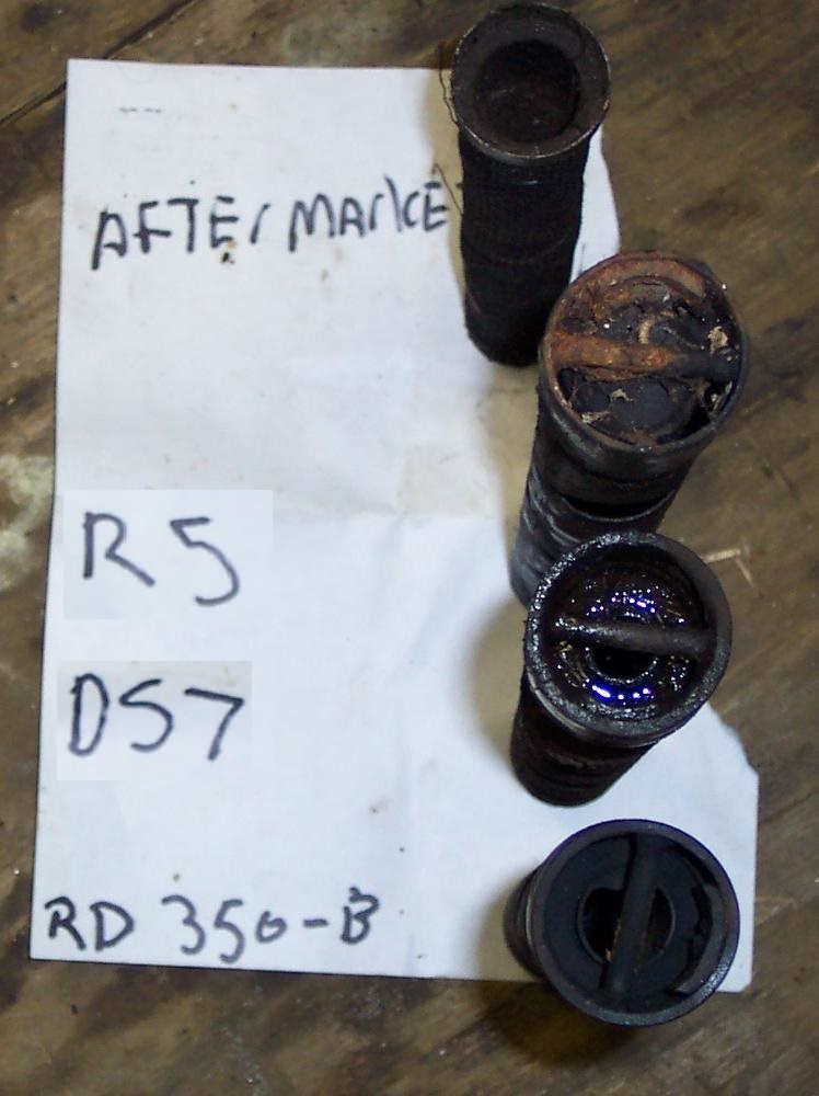

Pravin
Hi ,
Please check the pics , this ia 350A/B exhaust we cut open to check ....
The first plate from the crown nut has 4 holes in each exhaust .
So now the question we are trying to solve is what will happen if the holes are not there in that plate.
Regards,
Pravin

Pravin
These are pictures shared by my friend Mr.Gautam with whom I am doing some research on the AC RD Exhausts ..he inspected thus 350A/B in uk and he's a old time member of Uk Air-cooled forum as well ...and  I did scopy for indian 3 varients of exhausts and found that in indian exhaust we have 4 on left and 6 on right compared to 4x4 across other models abroad
Trying to share scopy videos ...
Regards,
Pravin

Pravin
Quote from: scully on September 21, 2021, 10:38:05 AM
My RD400 has the holes in the baffle plates....Like I said you'd never have known they were there until you burned out the pipes of carbon and oil.
Agree unless you have a scope cam or burnt exhausts ..This was started when I was thinking of putting USA exhausts and dropped the plan due to costing part.
Then I wanted to try if the aftermarket ones are close to Yamaha specs ....now for that I had to study my own and few other sets externally with measurements and then I got a cheap scopy cam :) and tried to look inside and got to know about holes , baffel distancing etc ....
So all Yamaha exhausts we studied has the holes on first baffel .... But the aftermarket didn't have any holes
Regards,
Pravin
Pravin
So the question remains ....
What's the significance of 4 holes on first baffel plate in rd exhausts ?
There has to be some thought and r&d involved right ?
Cheers,
Pravin
