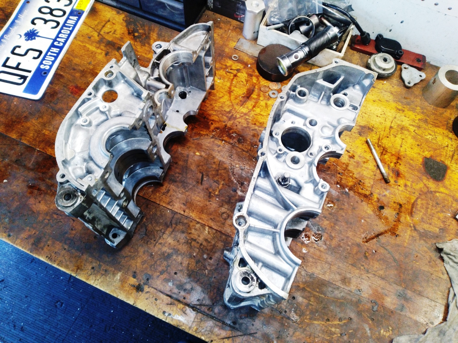

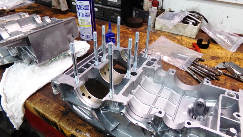

its the 3768th 73 made.. maybe? if it is, its obvious to see but an easy fix. hell, its alredy drilled just not tapped if it IS early. dont sweat it.
these are the ones i tapped for what is now the LC motor, they were blank w no threads, ist time id ever seen that. had the r5 style stepped washer on the main shaft behind the clutch, was weird. R5 cases do NOT have the bosses cast in.
